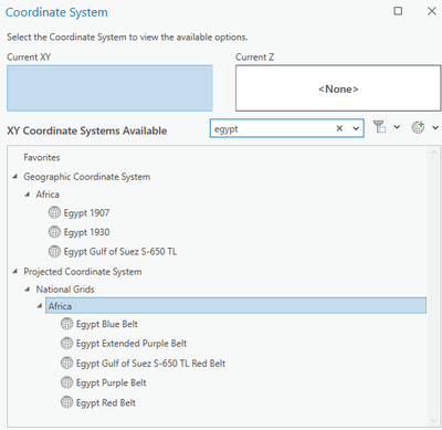

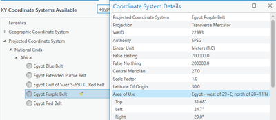

@MAMDOUHZALAKY
It is recommended to transition to using ArcGIS Pro. I am using screenshot from Pro but you will find similar coordinate systems for Egypt in ArcMap as well. AyanPalit_0-1694429799341.png
Please review the suggested area of use and choose the one that best meets yours need depending on the specific data location and mapping needs,

AyanPalit
@MAMDOUHZALAKY
