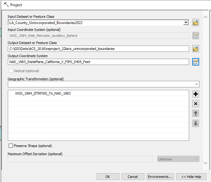

Like the title says, my data will not line up after reprojecting into the coordinate system I am trying to match with another.
I have an existing layer called AA_Cities and a newly downloaded shapefile called LA_County_Boundaries2022.
AA_Cities is currently in NAD_1983_StatePlane_California_VFIPS_0405_Feet.
LA_County_Boundaries2022 is being reprojected from WGS_1984_Web_Mercator_Auxiliary_Sphere to NAD_1983_StatePlane_California_VFIPS_0405_Feet.

Could you try a different transformation method, like "NAD_1983_To_WGS_1984_5"?
Transformation methods are bidirectional (works both ways).
How To: Determine which NAD_1983_To_WGS_1984 transformation to use (esri.com)

Hi Jayanta thank you for this info it is good to know. I tried your suggestion and the data doesn't seem to move at all. I have tried several transformations and followed the suggestions of the table listed below to no avail.

shot in the dark here: Make sure your data frame coordinate system is defined as NAD_1983_StatePlane_California_VFIPS_0405_Feet
