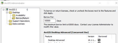

Wonder if You can use a 'borrowed' license?
You can increase the Borrowed license timeout to 65,000 days (178 years):
Of course, this won't help if you change computers.....
