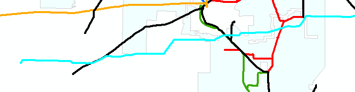

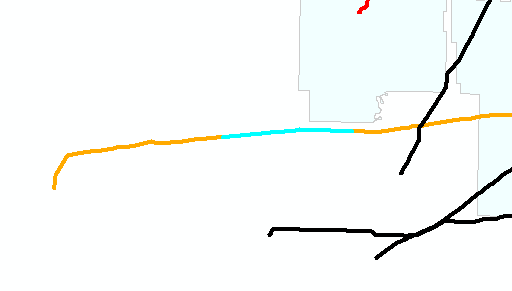

In ArcMap 10.3, when I split a polyline manually, I can see that the line is split when I highlight that part of the line.
But when I do a split at a specified distance, the line still appears as one single line and I cannot tell where the breaks in the line are although I can select each segment individually.  In the image below, I simply selected what should be the first segment but the whole line lights up as selected.
Why isn't the bottom image showing each segment like the first image where I manually split the line?
Thanks everyone!

The original line was one long line, several of miles of transmission line. I split the line to equal parts…7 to be exact.
In the bottom image, I only selected what should have been the first segment but it selects the entire line like it didn’t split them. But if I ctrl click where each segment should be, my attribute table shows 7 segments.
Even thought the entire line highlights as a selection, the attribute table does not show 7 segments.

For some reason, part of my lines were doubled and even tripled in some areas…several lines laying on top of one another. I have no idea how this happened. So I was splitting one line but being shown another. Very strange. Weird things happen when you use third party software with ArcMap.
