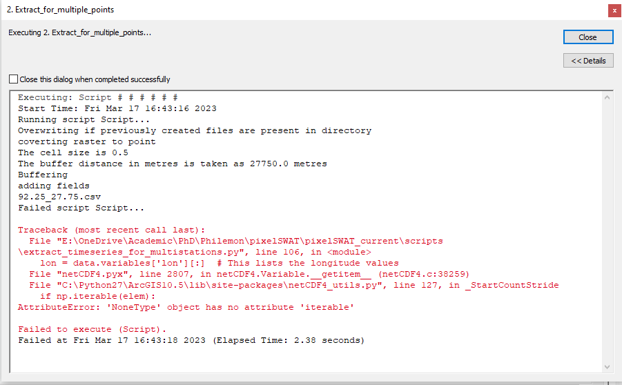

Now, the script tool seems to run perfectly for the first time. However, after that if I want to use the tool again, it throws an error.
Digging deeper led me to the conclusion that the issue starts when line number #22 is run. @HendrikBernert1 raised a similar issue in which he found out a workaround https://community.esri.com/t5/python-questions/arcpy-script-using-sqlalchemy-and-pandas-only-runs/td... . The workaround is to import the modules in the ArcGIS python console before running the script... once that is done, the script runs normally end number of times. However, that is not an actual solution to the script issue.

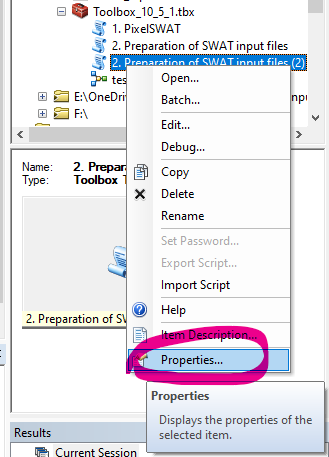

Thank You David! I think I accidentally stumbled on a solution to the issue. I can now use the script as many times as I want without having to import the modules in the ArcGIS Python console every time I open an instance of ArcGIS. I wanted to make my script more interactive, and so I had to explore the use of the validation tab in the script properties (fig.1).
In the validation tab as shown in the picture, by default, it only imports the 'arcpy' module by default. The solution is to import all the modules used in the script, or even better, find the modules which is causing the issue (in my case it was 'netCDF4' module) and import it in the validation tab. This solved my issue of 'nonetype error' and the script running only once in ArcGIS.
