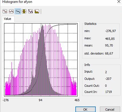

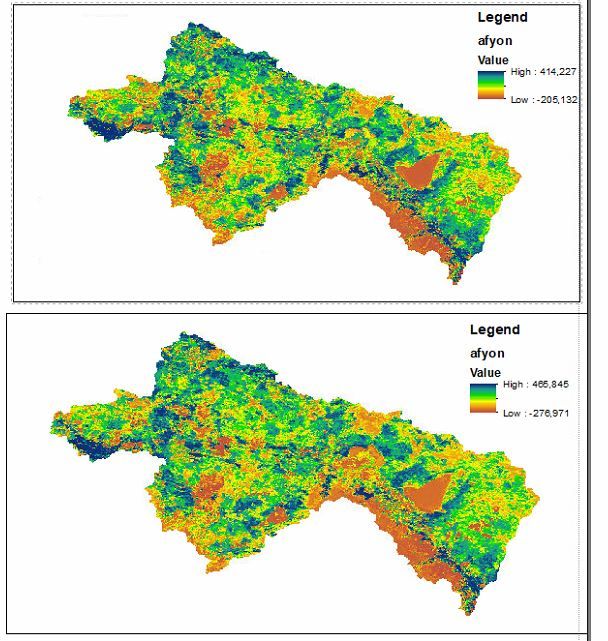

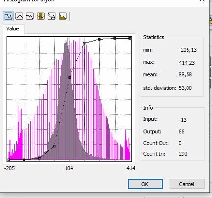

Hi all,
I have a big data set that represents the amount of net primary production of the area. I would like to compare two main raster datasets but when I add same symbology properties they look pretty much the same. I tried every stretch type but I think I need to set custom properties so that I can emphasize the difference between the two.
I would like to know your opinions for these two raster datasets stretch type? Can you suggest one?

Set your own class breaks so that the full min to max of both datasets are covered
eg 200-250, 250-300, 350-400, 400-450, 450-500 (perhaps at 25 unit increments.)
You will see the "shift" in the median and a "compression/expansion" in the range
