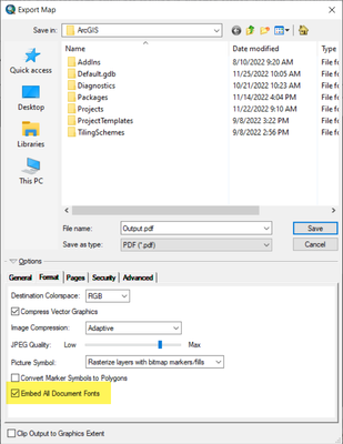

Did you click the option "Embed All Document Fonts" in the Format tab?
GinoOddone
Yes and with both scenarios the result is the same.
