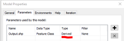

I don't think you can change this parameter to Derived in the Model Properties. This works for script tools or python toolboxes but not ModelBuilder tools. At least in my case in ArcGIS Desktop 1081.
But if you edit your Model > Select Managed in your Output Parameter > then Save the Model:
This will change it to Derived in the Model Properties:
