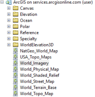

Here's the weirder thing. When I add the basemap from the arccatalog rather than from the add data button on the toolbar I do not have this issue. Arent these the same basemaps?

I created a GIS Server connection to services.arcgisonline.com, as Nicholas shows, and added the World Street Map from the Catalog pane, and can confirm that this does NOT cause the issue. To answer his question, yes, the basemap and the GIS Service are the same rest endpoint. BUT... one is being added to a Basemap group in the TOC, which Arc processes differently than other layers.
I created a new basemap group in the TOC, and moved the working GIS Service added from Catalog - the behavior returned. When I moved the service out of the basemap group, everything rendered properly again.
I tried the inverse - adding a basemap form the drop down and then moving it out of the basemap group. This also fixed the problem.

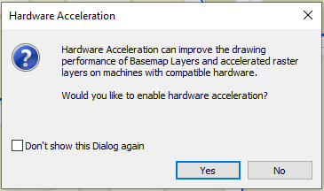

Lastly, I tried turning off hardware acceleration, as Tony mentions. At first, this caused Arc to act buggy - when I tried to add a basemap, the window would pop-up quickly and then automatically close. I restarted Arc and was able to add a basemap with hardware acceleration turned off. I got this pop-up:
The map works with a Basemap group and hardware acceleration turned off, but it is very slow. I think removing the basemap service from the basemap group in the TOC is a better fix.
