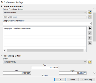

tomGIS
I have selected "Same as Display", but it is not working. 😞
DavidPike
MVP Notable Contributor
Did anything change as a result? Are you overwriting the layer or creating a new output? (ensure the output is added to the map)
Are you able to provide clearer screenshots of the input data you're creating the kernel density from?
I'm also going to point out that it seems you're running density analysis whilst in WGS84 coordinate system, you should be using a planar coordinate system, as the output will be pretty meaningless otherwise.
