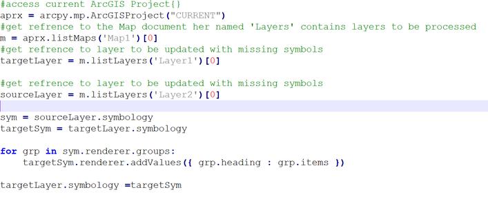

I was able to test the ArcPy method in a sample map and it worked successfully but some time it was just copying classes without symbol and some time it was working as expected (I had add some code to update symbol colors in this case).
Here is the code for anyone who may face the same case:
However, when tried on my MXD after importing to ArcGIS Pro project it didn't work, I did many trials to understand the issue, one of the trials was to create new layer from same data source apply symbology using same fields, and keep default symbol classes (auto defined) then delete part of the symbol group and then redo the same for another new layer while keeping the other part of the symbol group and then try the script it works successfully.
The only difference I can see is that in the new layer I can go to layer symbology press add missing value and then choose the add new value option, it work in the new layers while when I try the same steps on original layer I got the error message "Requested operation could not be completed" with no further details I believe if I can fix this issue then the script will work.

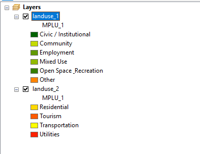

Can you send a screenshot(s) of your current symbols/classes for a few layers for me to properly understand this?
ahmed_hussiney
Hi David,
The following is a sample screenshot, I had two input layers landuse_1 , landuse_2 both of them is classified using "MPLU" field, but each layer is only concerned of set of sub-classes of the MPLU , As in the screen the layer landuse_1 has only 6 classes while landuse_2 had only 4 classes, I want to load all the 10 classes into one land use layer.
I should keep the same symbol and same classes, This is only a simple show case to clarify the issue.

ahmed_hussiney
