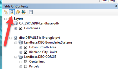

In the table of contents, you can also list by data source:

It shows me only the feature dataset but I need to know the name of tables the provide data for each feature class or feature dataset ? How could I get table names ?

Are you talking about joined/related tables?
Basically, in my example above, "Centerlines" is a table in the geodatabase.  It also has shape field holding the geometry so Arc can display it as a feature class when added.
So, the table "name" would be "Centerlines".  If you right-click on it and open attribute table you can view it.

Not if the layer name has been changed in the TOC.

Or if you have an Alias set on it.  That is why I used Centerlines as example, not Urban Growth Area (that is alias, but, it IS the table alias).
Just trying to clarify what a table that provides data for a layer is.....
