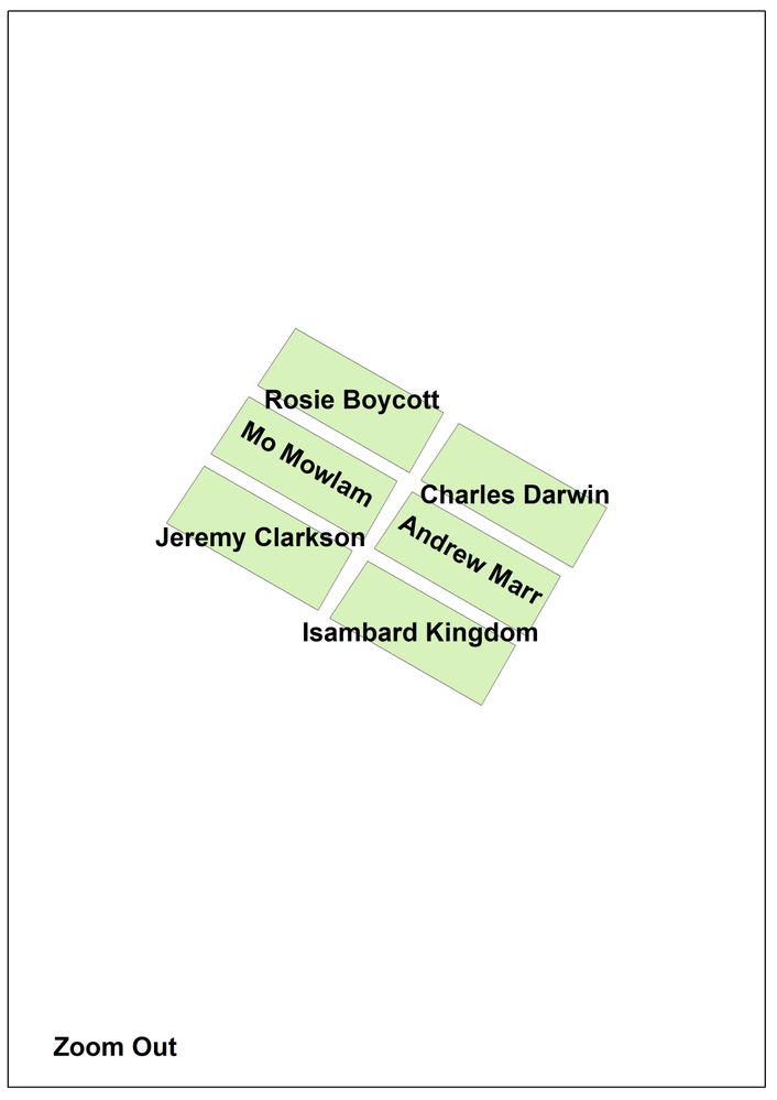

I want to label polygons features alwayes straight , but when i try to change the scale or make zoom out the label placement changed to be horizontal my question is how i can keep the lapel placement to be straight alwayes ? is there any solution or workaround ?

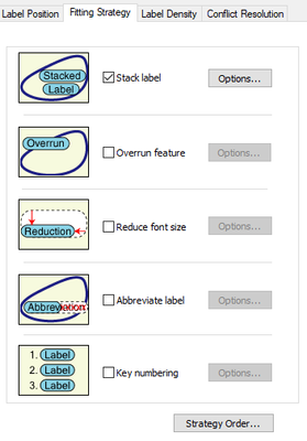

it is doing that because the label is to long to fit in the polygon anymore.  If you are using Maplex
There are some options you can manipulate for the labels or alternative ways of doing things.
In label options when the label exceeds the size of the polygon it will go beyond
RobertBorchert_1-1655467960306.pngIn the setting you can turn off Overrun feature.
However, when you turn that off the label will disappear when it gets to big. However you can turn on stacking
However, it will still disappear when you zoom out.
So you select Reduce Font Size and go into options and set the max amount it will reduce font size.
Last you can try Abbreviate Label. For this you need to create abbreviation dictionary.

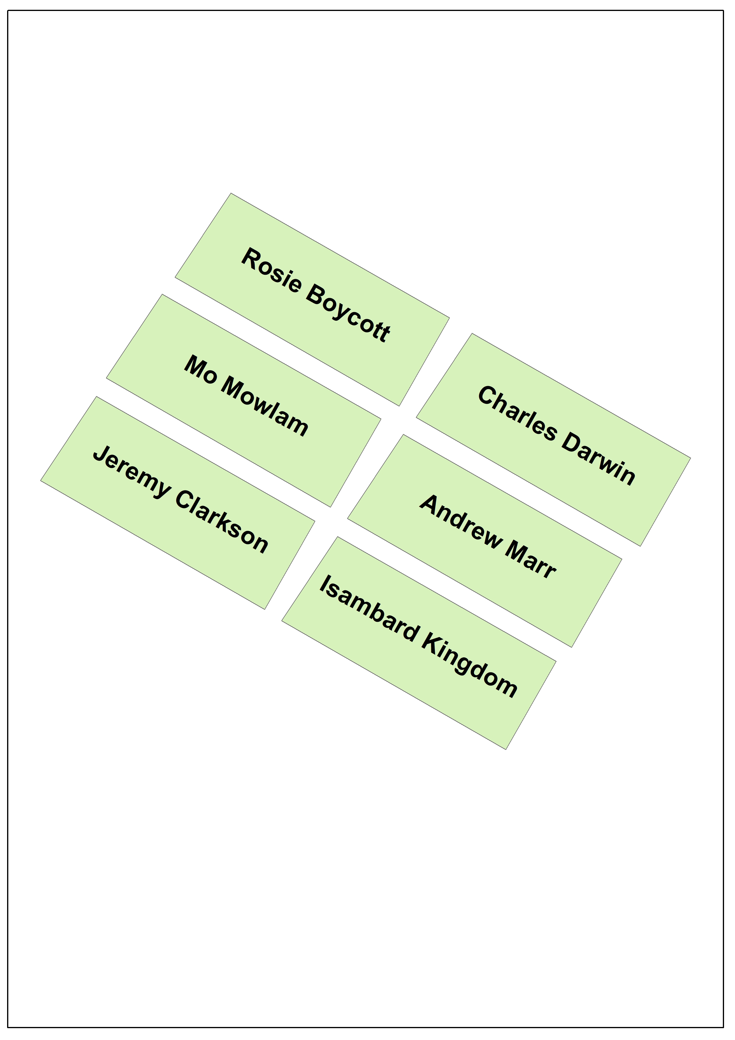

The alternative is to create annotation.  Annotation will stay the same size relative to the polygon no matter how far out or in you zoom

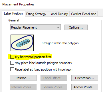

JesseWickizer
Esri Contributor
Uncheck the Try horizontal position first setting on the Maplex Label Position tab.
