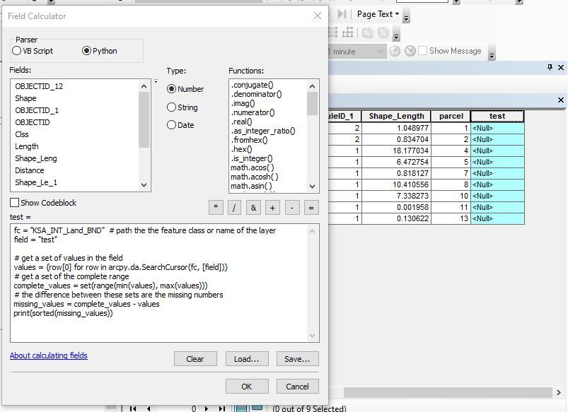

what should I change in your Python script to work , I create field test to run your Python script but it does not work ,  I want to know the missing number in field parcel ….I need more details!!!

The script is meant to be run in the Python Window, not in the Fieled Calculator.
  • Open the ArcMap Python Window
  • Copy/Paste the script into the window
  • Change the first two lines
  • Execute by pressing Enter (may have to press it twice)

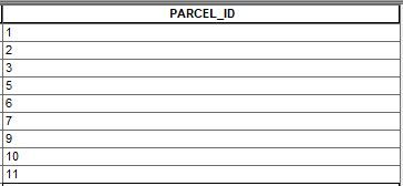

Ok now its work …. but can we make another change in the python script to let him give us the missing number in group A and the missing number in group B , because the missing number in group A is different than the missing number in group B.
