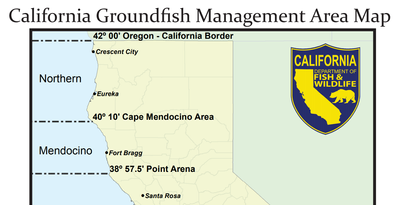

Hi everyone,
I need to add reference lines at specific latitudes, like the image here: <https://nrm.dfg.ca.gov/FileHandler.ashx?DocumentID=113031&inline>
Here's what I've tried/found so far:
- I found ESRI's base layer lat/long grid, but the resolution is not fine enough (it only goes to 1 degree)
- I found another group of files hosted by USGS (I believe) that had the resolution I need, but not the extent (I need it to cover California but also into the Pacific Ocean)
- I saw something about a "Reference Latitude" tool, but I don't appear to have the proper license to use it
- Lastly, I saw references in a couple of semi-similar questions to the "Create Fishnet" tool, but I honestly can't figure out what parameters to use to get what I need -- if someone could break this down for me, I would so appreciate it. I'm using the California Teale Albers (meters) projection.
This seems like something that would be really simple, but I can't figure it out. Thanks for any ideas/help.

You want specific latitudes or longitude lines, not a regular lat long grid ("graticule") so I don't think fishnet (or graticules and grids - a property of the data frame) are what you are looking for.
Here's a fairly simple approach:
Create an excel sheet with lat long points at (or beyond) the ends of the lines you want to draw (long-lat in decimal degrees) and create points  (Display XY Data). Be sure when you load the data to specify a GCS (the default in ArcMap is the data frame coordinate system).  Then create a line feature class and use the ArcMap editor to draw the lines, snapping to your points.
Or, you could create a line feature class in GCS, and use the ArcMap editor to type in the XY coordinate vertices (with a data frame set to GCS so you could see what you were doing).

I cant seem to access that URL so not sure exactly what you mean, but I guess it's just a grid of Lat Long to minute etc. precision.
If so, Create fishnet would definitely be what you need.
Create Fishnet (Data Management)—ArcGIS Pro | Documentation
How Create Fishnet works—ArcGIS Pro | Documentation
You would just set your coordinate system to Geographic Coordinate system WGS84 when using to tool, rather than your current Projected coordinate system Teale Albers.
For example, the input for x origin coord at 0 deg Lat and 0 Long would be ('0, 0'), to be oriented North, y coord would be ('0, 1') and the cell width/height would be decimal degrees i.e. 1 minute would be (1/60).  Then specify the number or rows etc.

Could you access the URL? So is that what's meant by specific i.e. a non regular grid?
If that's the case then you could just delete the lines from a polyline fishnet or conversely select the lines you need and either export or switch selection and delete.

Yes the URL works for me. here's a picture of it for the good of the thread.
