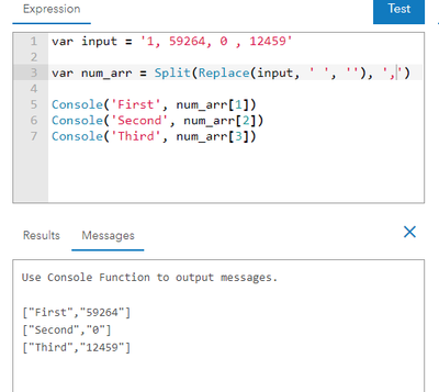

You could split the input string and access the value by index.
var num_arr = Split(Replace($feature['Comment'], ' ', ''), ',')
return num_arr[2]
- Josh Carlson
