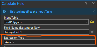

JoãoToscano
Thanks for the quick reply, I'm relatively new to working with Arqgis, how do I change the Field Calculator language to arcade?
JohannesLindner
MVP Alum
But this is for ArcGIS Pro, and I didn't realize that you posted this question in the ArcMap group.
If you're working with ArcMap, it's much easier to do this task with a little Python script.
