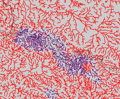

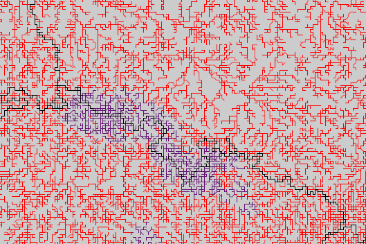

I wanto to export the layout view into vector-based graphical format for publication purposes. It seems the vector format is resolution dependant and ArcMap first rasterizes the layout and then it exports the pixels into vector form!
The problem is that I cannot obtain a fine resolution file without a pixel-like view and the exported file is very big.
Zoomed-in view of the original layout as seen in ArcMap window (screenshoot):
Zoomed-in view of the exported PDF in 300 dpi resolution:
