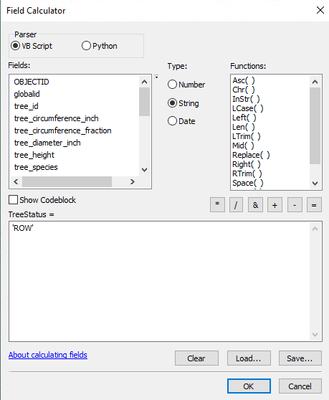

ArcMap 10.7.1 I'm trying to calculate a text field:

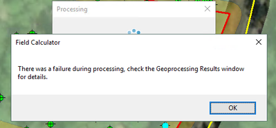

But

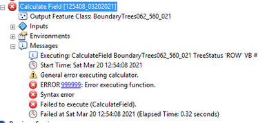

This is what the geoprocessing results window has to say about it:
Any thought?

Use Double quote "ROW"

use quotation marks and not a apostrophe
