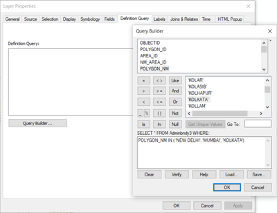

I am trying to have only certain cities be on my map and I can't seem to get the attributes table to work in the query (so I only need 3 cities to show up instead of 1000s). When I use the query function it verifies my query but returns no value. I would also just like to display in the legend those 3 cities or all cities then I can just uncheck all the others but the 3 I need to display? Sorry if this is a stupid question - I am using ARCMAP 10.8. I used to use ARCVIEW and ARCGIS 8 but am new to the changes in this version.

You could use the Definition Query.

Use the "definition query" as noted by JayantaPoddar.  Please provide your query, and a snippet of your city's attribute table, and feedback can then be provided on why there are no values returned.
