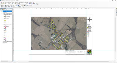

Hi Everyone,
I am trying to take this layout I made and divide this utility map into smaller sheets for field use.
Kara_Shindle
What's your question?  Are you trying to go for match lines or are you wanting to know how to make a data drive page/map series?
I'm thinking map series - https://desktop.arcgis.com/en/arcmap/latest/map/page-layouts/creating-data-driven-pages.htm#
Set up a grid, and it will generate a separate layout for each section of your grid.
