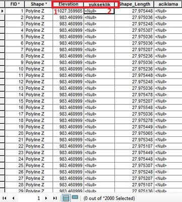

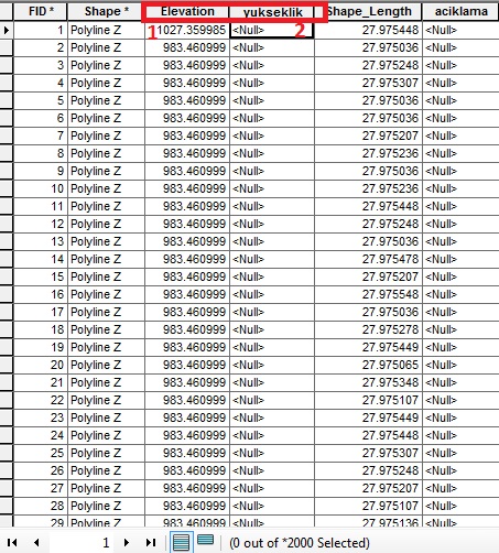

I have two different field with different properties as can be shown from photo.
I need to copy one field  properties to another but it gives error "The value is you entered is out of range or is not a whole number"
First field type is double second one is float. Thanks for answer.
I uploaded file as an mdb. the field name is "munhani".

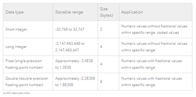

Just from a basic data type standpoint Double has a higher range than Float.
Having said that, it is easier to move a data from a Float field into a Double but not the other way around, not without data loss. You may refer ArcGIS field data types
In your case, you will have to Add Field to create a secondary field with field type as Double and use Calculate Field to populate the data.
I hope this helps!
