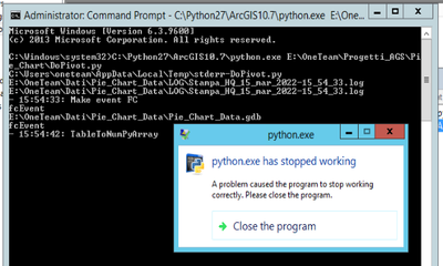

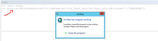

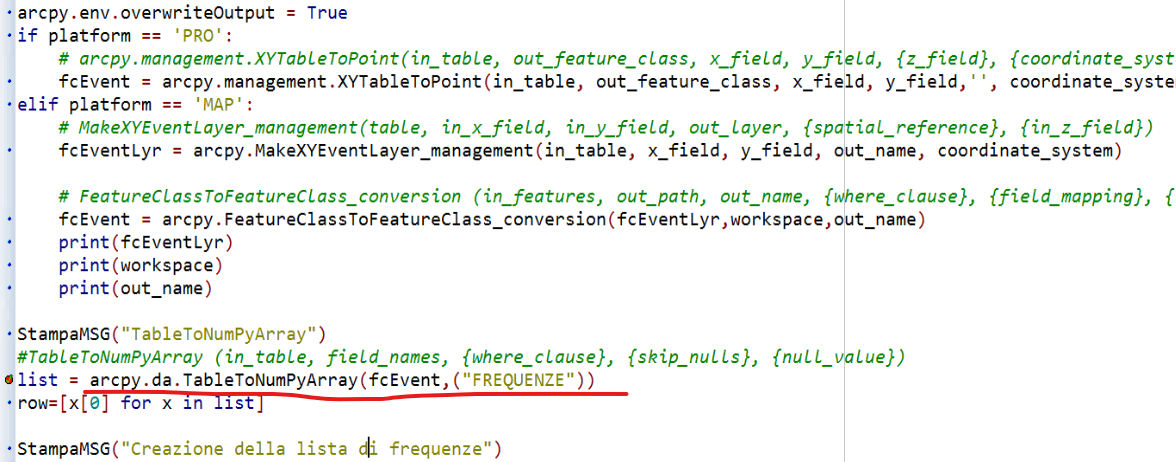

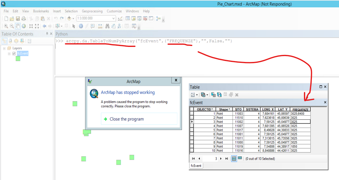

I've a python Script that create an XY Event, save it to FC and create a list using arcpy.da.TableToNumPyArray.
On TableToNumPyArray arcmap crashes also with "run as administrator" and on python window
Same script, dveloped on my laptop with 10.8.1  run without problems!
Same error not using Background geoprocessing.
Anyone has any suggestion to try?

AlessandroValra
It's very strange because the table contained only 10 records for test.
I completely eliminated the command arcpy.da.TableToNumPyArray with a loop on single record of a table.
Now it runs without problem.
I'm surprised, because I still can't explain the problem. Maybe a 10.7.1 bug?
Thanks.

Did you try
input = (fullpath to fcEvent)
arcpy.da.TableToNumPyArray (input, "FREQUENZE")  # drop the other parameters

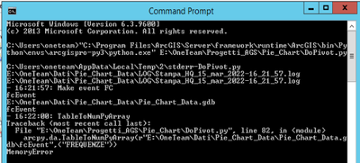

AlessandroValra
OK, maybe I must change strategy...
on Python3.7 there's a "memory error".
I must change code to use a slower search cursor....
DanPatterson
MVP Esteemed Contributor
sounds like you ran out of memory, you will have to split your tasks into smaller bits or subdivide the data for processing
