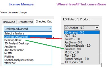

I've just started providing technical support for this tool within my company and have been looking for for a tool like this, so please keep in mind I'm not a user of ArcGIS and technically this is new to me.
It seems that the Product List in WhereHaveAllTheLicensesGone doesn’t match the “Features” in the Arc GIS Licensing Tool. They all match except what I see as 'Advanced' is called “ArcInfo” in the tool and the 'Basic' is called “ArcView”. Also, in the tool the products all have 9.0 after the product name and we have 10.8.1 installed.
@AndresCastillo  Any suggestions on why this differs? I want to offer this to our users by installing the WhereHaveAllTheLicensesGone on the shared desktops, but I'll have to explain how to know which is Advanced and which is Basic.
Thanks in advance!

Hi @JessikaTischleder ,
"ArcGIS for Desktop is available in three license levels - ArcView, Arc Editor, and ArcInfo. Starting at ArcGIS 10.1 these same levels are re-named to Basic, Standard, and Advanced, respectively."
https://support.esri.com/en/technical-article/000002706
It seems like the original developer of the tool hardcoded the dropdown values at version 9.0.
