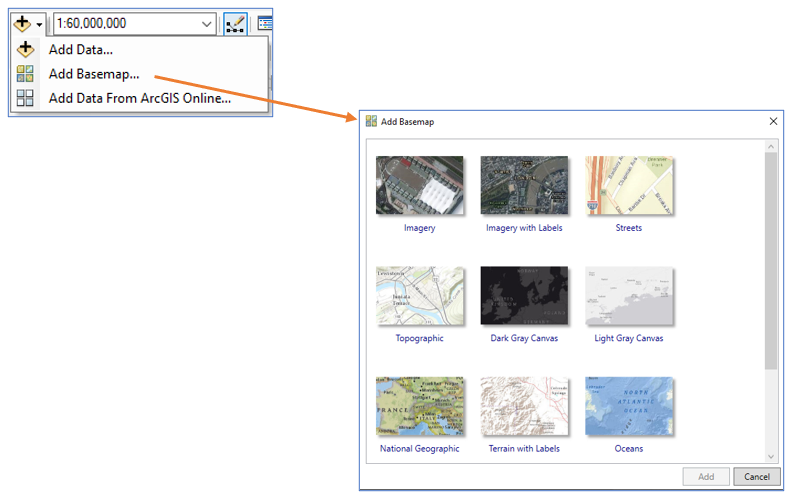

  • Raster tile basemaps added from the Add Basemap gallery have been using HTTPS for a number of years, so unless you have very old map documents, it is unlikely that these documents will be affected. KoryKramer_0-1647877751698.png

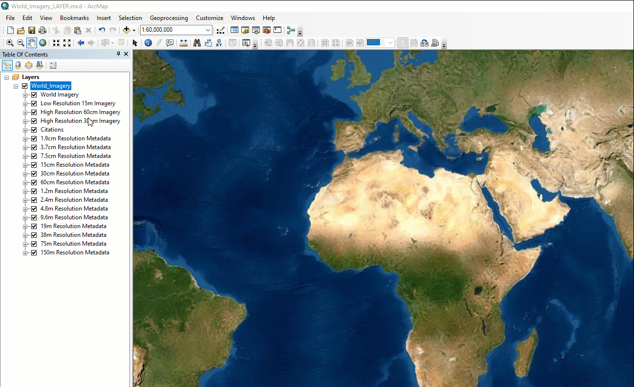

If raster basemaps were added from a server connection as a layer (i.e. they were not added from the Basemap gallery), go to the Layer Properties and open the Source tab to determine if the connection is using HTTP or HTTPS.
If the Server property is using HTTPS, no action is needed.

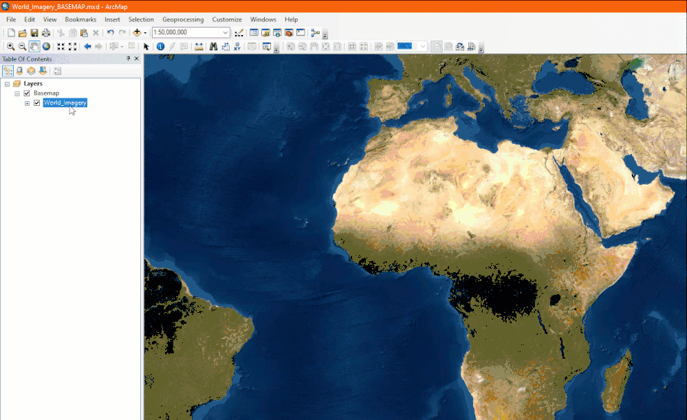

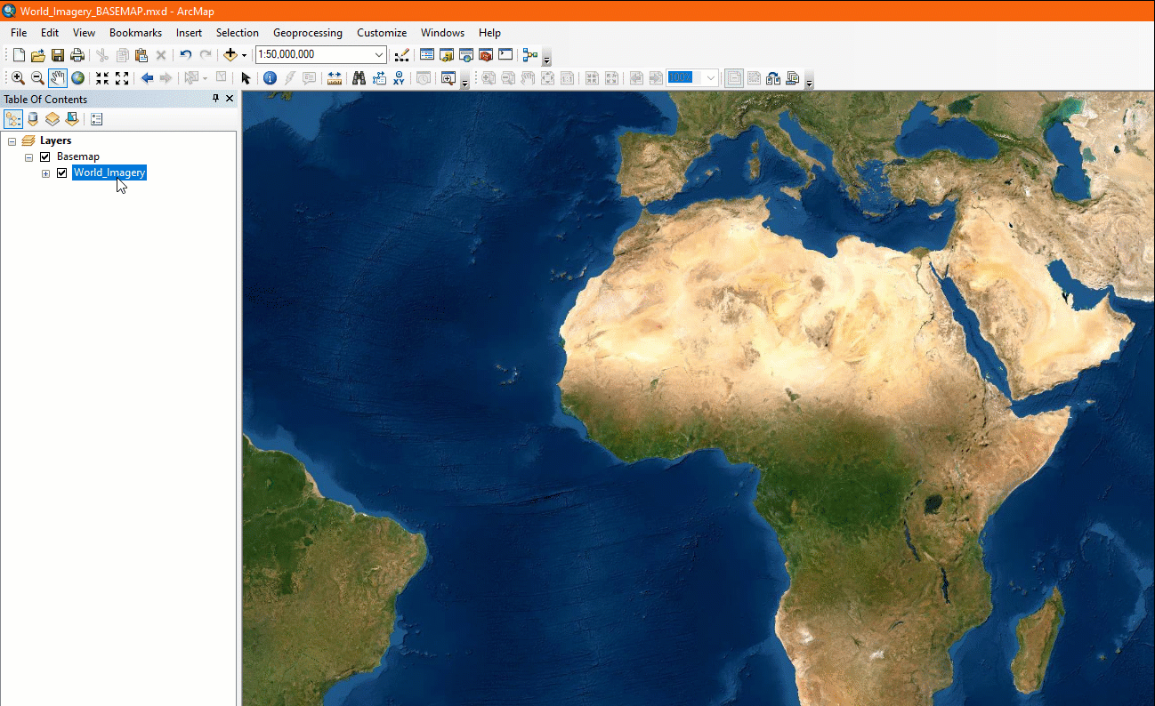

If added from the Basemap gallery, the layer will be part of a Basemap group and the source properties will not be exposed. Move it out of the basemap group in order to see its source properties.
If the Server property is using HTTPS, no action is needed. You can move the layer back into the Basemap group to optimize performance.

Added from Basemap Gallery
  1. Add a new basemap from the basemap gallery which will use the HTTPS protocol.

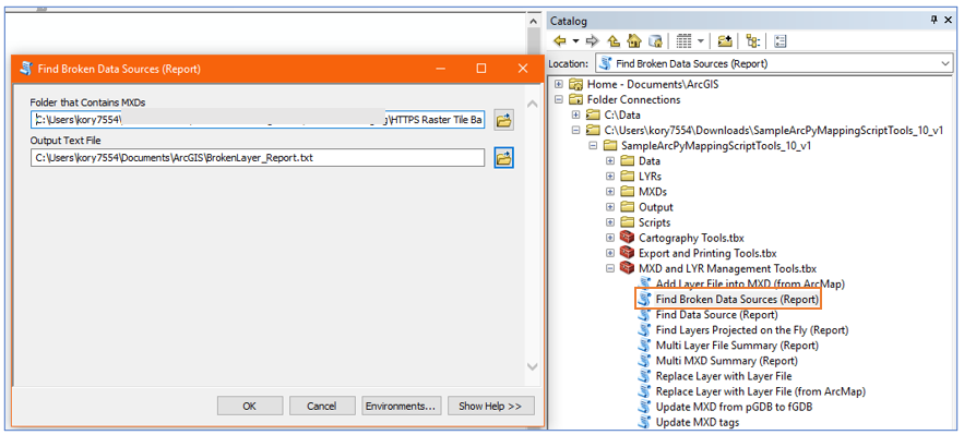

  1. Go to SampleArcPyMappingScriptTools_10_v1 and download the zipped files.
  2. Extract the files.
  3. Create a folder connection to the SampleArcPyMappingScriptTools_10_v1 folder.
  4. From the MXD and LYR Management Tools.tbx, open the Find Broken Data Sources (Report) tool.

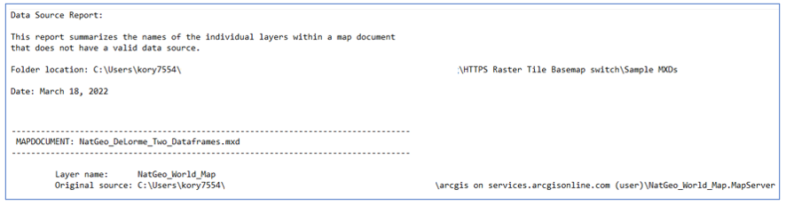

The tool will generate a report of .mxds containing broken layers that you can inspect further.
Because Find Broken Data Sources (Report) is a script tool, it can be used as a starting point and be modified to customize checks.
