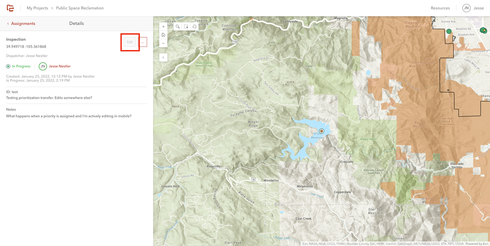

FWIW I'm running into something similar on the Assignments layer. I'm trying to update the Priority field with a score calculated from a Survey123 form, and I'm using Microsoft Power Automate. I've tested extensively and pinpointed the issue to conflicting edits. The workflow to reproduce is:
  1. Mobile worker is editing in offline mode
  2. The mobile worker submits the survey and initiates the Power Automate flow
  3. Power Automate posts the new Priority to the assignment
  4. Mobile worker "finishes" the assignment or otherwise makes edits
  5. Mobile worker syncs edits
  6. The assignment loses the Power Automate edits but retains the mobile worker's edits.
Something similar happens when the Power Automate flow runs while a dispatcher is editing.
My ideas are that:
  1. You somehow delay the flow from running instantaneously
  2. You run a script overnight that updates those values for the next day
  3. You figure out a way to check whether a feature is being edited, and make the flow wait to post its update until the feature is no longer being edited.
There must be a way to do idea 3, because the dispatcher side has the edit button disabled when mobile workers are actively editing:Screen Shot 2022-01-25 at 2.21.27 PM.pngScreen Shot 2022-01-25 at 2.21.27 PM.png
Maybe this illuminates something for you or ESRI...
