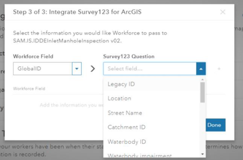

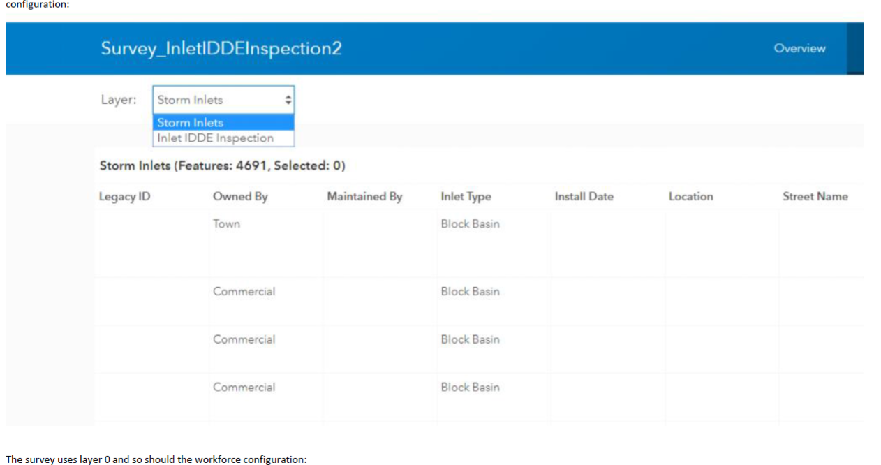

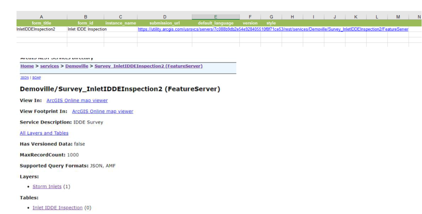

When configuring Workforce to Integrate with a Survey123 form, the survey123 questions that are presented to be linked are coming from the layer 1 in the feature service (a feature layer), which unfortunately is not the target layer for the survey, which is layer 0 (a table). Those table fields are not available. We are unable to tie the workforce project to the survey correctly.
I hope this makes sense.  Thanks for any thoughts on correction or workaround.
Sam

I was looking for this function a while ago and for some reason(which I do not know of), certain types of Survey123 Questions such as select_one are not seen in the "Step 3 of 3: Integrate Survey123 for ArcGIS". There is a workaround for that by running a Python script. Might want to take a look at Workforce Integration with Python. Hope it helps.
Thanks,
Pauline
