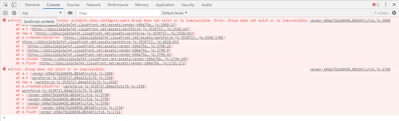

Are you able to open developer options in Chrome or Firefox (right click on page and go to "inspect element"). Then open the "console" tab. Do you see any errors?
After you do that, leave the developer tools panel open and re-open the Workforce Project and go to the users tab. In the "Network" tab, do you see any failed requests?
Here's an example with the network tab open.
ChelseaTabor1
Here's what I get when I access the users tab on my project:

Okay when Workforce creates a Project, it also creates a group to manage peoples access to the Project. It seems that the group that was created is not available to you or maybe it was deleted. Can you check that you have access to a group that is named the same as your Workforce Project?
ChelseaTabor1
I definitely deleted that group and moved the project and maps to another group I'm a member of.  Can I recreate the group, or will I need to recreate the entire workforce project?

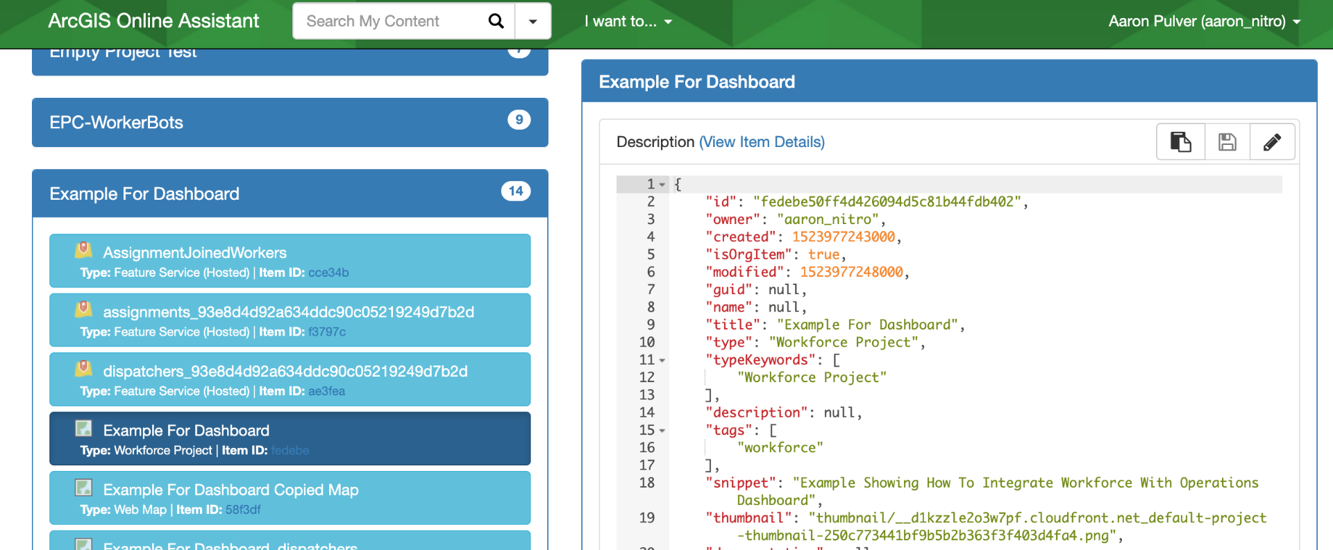

Then sign into AGO Assistant and select "I want to 'view an items json'". Then select the project (type="Workforce Project") in the left hand panel.

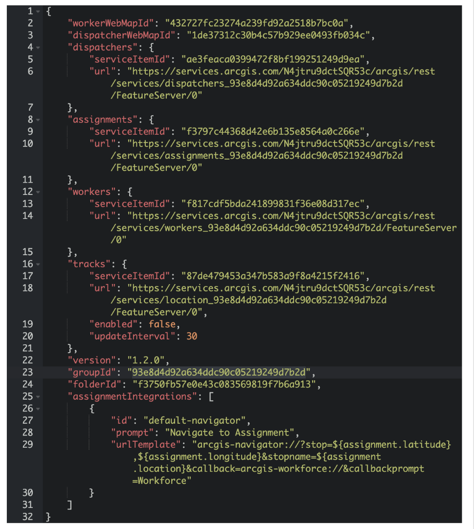

Then scroll down to the "Data" section and click to edit the json. Then replace the "groupId" id with the new group id you previously copied to the clipboard.
Then save the changes.

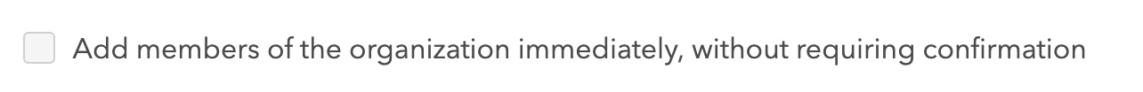

When you add them to the group, make sure you check the box to automatically add them.
