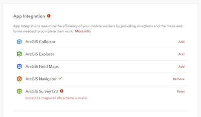

@CraigGillgrass ,
One other thing I did notice when I changed the URL parameters to open the web app in edit mode - The Workforce project settings page is showing an error for the Survey123 app integration.  See the screen shot below:
I don't know if this will really be an issue or not, but it does tell me that the URL scheme for the web app in edit mode is technically "not supported."

"One other thing I did notice when I changed the URL parameters to open the web app in edit mode - The Workforce project settings page is showing an error for the Survey123 app integration.  See the screen shot below"
  • This is by design - the URL scheme for the web app in edit mode is not possible to configure OOTB and therefore, is technically not supported. However, as long as you are following the documented guidelines for Survey123 and how to construct the URL scheme, it should work.
