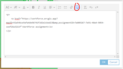

The following link works for me. It opens workforce and the specific assignment. A good strategy is to first just create a link that opens Workforce. When that works, add a mapID and finally a assignmentID by reffering to the Global ID. I´m not sure you need the portalURL at all.
<a href="https://workforce.arcgis.app?mapID=92a54bce9afa4de9b741f3d2e2cbed23&amp;assignmentID=7a009267-7e91-40a4-9054-ceef26a3211f">Workforce assignment</a>
 I did not use Arcade at all to create this. I just added a text element to the pop-up and worked with the source view.
