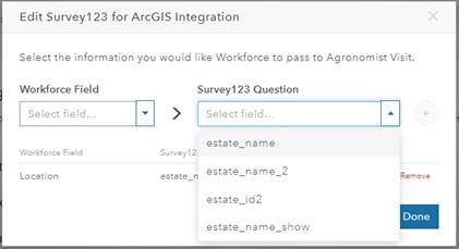

Pauline_Low_Pui_Ling
Hi Craig,
Was wondering if there is any update on this function? I was just trying the pop-up from layers but was told that workforce in Android devices do not read the pop-ups instead and was told that the only the basemap could be seen (which has no layers with the pop-ups). Would be a helpful feature to have.
Because of the limitation on this original post, I am trying to pass in parameters using the given Workforce and Survey123 integration function. Any workaround to pass attributes on workers map to the survey123 select_one types?
Could not see estate_id here...
Workforce integration with Survey123 does not recognise the select_one types in Survey123
estate_id is a select_one type in Survey123...
Hope to hear from you.
Thanks,
Pauline
CraigGillgrass
Hello,
With the Workforce release that is happening tonight we will be adding the ability to pass any field to any of the apps such as Survey123, Collector or Field Maps.
Please let me know if you see any issues with this.
thanks,
Craig Gillgrass
