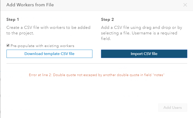

Under the Users tab, I selected "Add workers from file" and downloaded the template csv pre-populated with existing workers. I went through and tried to edit this template file so that I could easily assign expertise levels and edit the notes section.
The notes section currently has their email in it, so in excel I was able to use a formula to concatenate the userId field and notes field into "username, email". I saved it, then imported it into workforce and receive one of these errors every time:
This error comes up even if I download the pre-populated template and then import that with no changes. At this point it would have been easier to just edit all of the workers manually, but soon we will have almost 100 workers that may need mass updates.

Karen,
Unfortunately, if the project is already live and worked has been created and assigned you'll have to edit the Worker records in place.
You could do this through Python, since that would allow you to access the rest API to get at the named user information.
