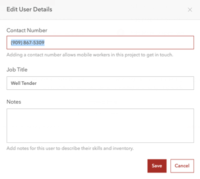

Inside of the configure experience, click on the USERS tab and then hover over a mobile worker. From here you can click Add details to enter information.
If you are updating existing information, click the pencil to the right of the phone number.
Within the dialog that pops up you can enter/update the worker information:
JimmyWalth
You are correct that this allows me to update the information.  But if the field worker I am updating is active then the information reverts back to the old information the next time they complete or start an existing assignment.  I have updated the information for all workers several times in the manner you outline but each time the information reverts within a few days.  It is very frustrating.  I can't seem to find a process that will make my changes stick.
