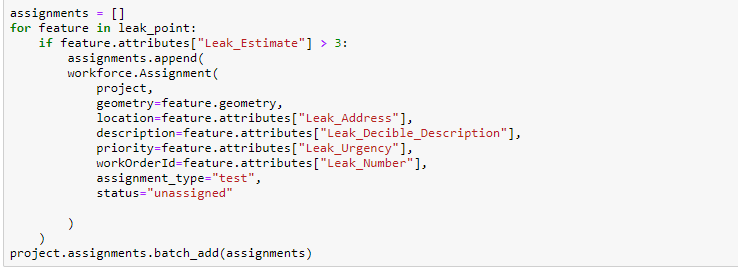

Following the "Automatically generating assignments in Workforce " I was able to get a script working for automating workforce Assignment generation. I would like to add a condition to this to first check for any existing assignments before generating a new one. To do this I would like to compare the ID number(leaknumber) in my webmap layer to the workOrderId in the assignments layer. If the webmap id number does not exist in the workOrderId field then I would like for it to generate a assignment.
Below is the existing input for generating assignments

Probably the most efficient way to do this would be to query the assignments layer prior to creating the assignment with a query like "workOrderId = '<your work order id>'. If that returns no features, then you know that assignment hasn't been created yet. If you have a lot of new work orders, it could be faster to query all of the assignments and then iterate over them in Python and check for matching work order ids.
