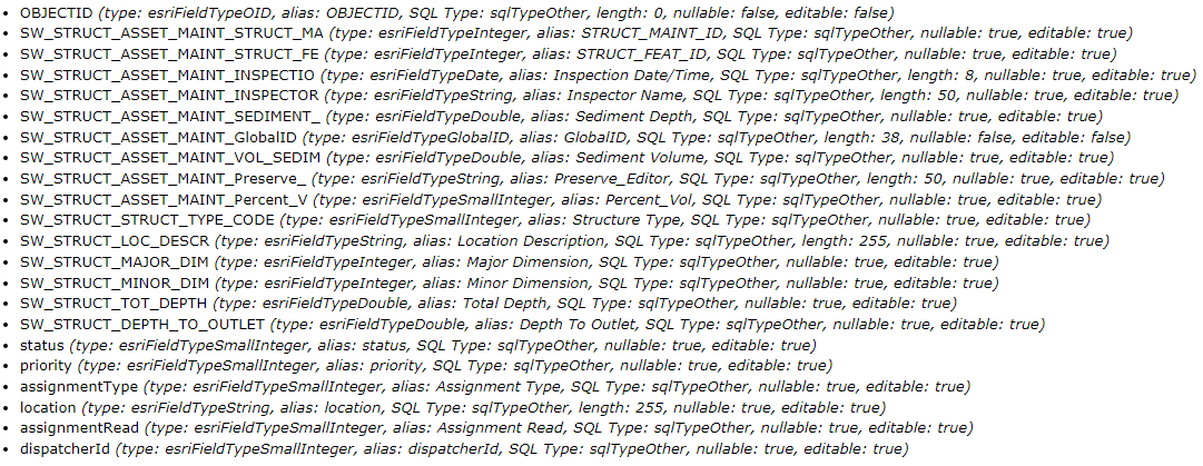

I am trying to overwrite the assignment with a layer that kind of follows these guidelines: Workforce schema—Workforce for ArcGIS | ArcGIS. I can see the assignments just fine when I open the workforce project but when I try to add workers I get "Item is not accessible" in dev mode of my browser.
Here are the fields I have in my layer:
So I have the fields I need to supply:
You need to supply values for the following fields:

1. Should I remove all the extra fields and keep only what is needed for workforce?
2. Is the process of overwriting the assignment layer breaking something in the app itself?

Are you trying to replace the existing Assignments feature service that is created when a Workforce Project is created, with a new, different feature service?
Craig
by Anonymous User
Not applicable
Correct.
CraigGillgrass
Hi Alex,
This workflow isn't supported with Workforce.  I'd like to understand the use case around replacing the assignments feature service that is created when the Workforce Project is created, with a new, different feature service.  Can you elaborate on why you're overwriting the Assignments feature service?
Craig
by Anonymous User
Not applicable
I am working on a storm water project. They have structure, treatment, and conveyance inspections collected in related tables in collector. In our workflow, each inspection record becomes an assignment with its own priority, status, assignment type.... for example: there is a broken pipe. The client wants straight from collector to be able say it is a high priority and send a crew of people out there. Workforce would be great for this.
What I ended doing is download replica, make each of the inspections records point features (instead of simple records), add and delete certain fields and republish to show them in collector where are the high priorities and low priorities.
