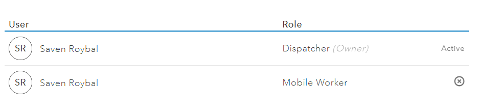

If I'm understanding your situation correctly, you have certain individuals who you would like to be able to both create assignments as well as to be able to complete assignments.
If this is the case, all you should need to do is assign those individuals both Dispatcher and Mobile Worker roles within your Workforce project.
1) Open the Project's settings from  your Projects page
2) Navigate to USERS tab
3) Assign the dispatchers the additional role of Mobile Worker
After that, the dispatchers should also be able to complete work in the field when needed.

Can I ask if you can clarify something; would you like the Lead Hand or Patrol Staff to be able to assign and complete work orders within the Mobile app?
Or, will the workflow that Saven outlines above, where a single user can act as a Dispatcher and Worker; but still must use the Web app as the Dispatcher, satisfy your requirement?
