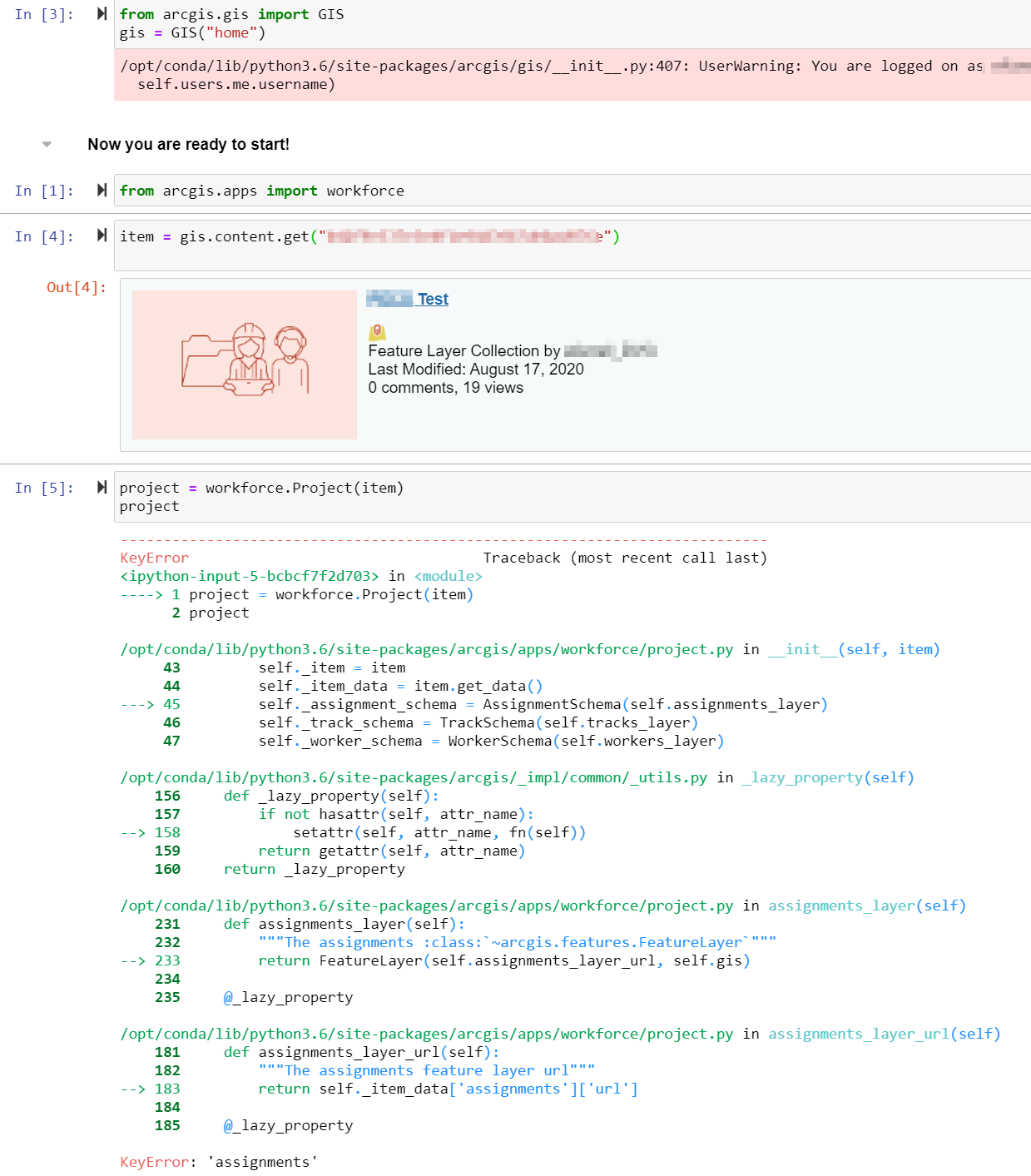

I am trying to connect to a "new" (not classic) Workforce project using the Python API. I am encountering an error (see below). This code works for "classic" projects, and I've seen examples of this working for new projects. I've reproduced this error using version 1.8.0.post1 and 1.8.2 locally and 1.8.1 within AGO notebook. Help appreciated.

You need to update to version 1.8.3 of the API which is in pre-release
conda install -c esri/label/prerelease -c esri arcgis

I was able to get around this by treating it like a regular hosted feature layer and pulling out the assignment layer by its index #
workforce_project_item = gis.content.get("itemidhere*****")
assign_layer = workforce_project_item.layers[0]
Worked without upgrading to the pre release (1.7.0)
