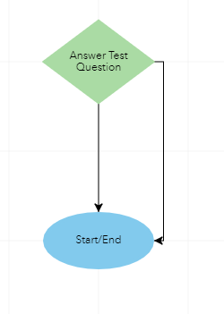

We are creating a Workflow for data entry from source documents.  I have create a workflow, a very simple (test) diagram, and associated that diagram to a Job Template.  I have shared the "Workflow"  (created automatically when I create a new "Workflow Item") with another group in my Enterprise called "Editor" and I've given the "Editors" group "Workflow Administrator" rights in Workflow Manager.

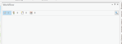

I can login to ArcGIS Pro, open the Workflow Manager pane and create a job no problem.  The problem is those jobs show up under the "My Jobs" tab in the Work pane if I enter Workflow Manager through my Enterprise (web app), but they don't show up in the Workflow Manager pane in ArcGIS Pro, so the user that created the job cannot open the workflow in Pro ("All jobs", "High Priority Jobs", "New Jobs", etc all say "0") .

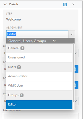

There are a couple of moving parts, but I promise it gets easier as you follow the workflow more often:)  I'm rereading the original message and I think I know what the issue is. When you create a job for someone else you will need to assign it to them or else they won't be able to see it:
Right now this job that I created is assigned to the admin, I will want to update that to the group so my other users can see it.
You can do this process in ArcGIS Pro as well: Assign Jobs in Pro
Now see if the user can see the job.

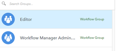

  1. In Workflow Manager, a Workflow item has been created and three items will be in your portal
  2. In Portal 'Editor' Group has been created - Add Portal users into this group (making sure these users have Workflow Manager licenses for Pro and the WebApp depending where the user will be working)
  3. Share Feature Layer (hosted, view) and Workflow item into the group
  4. In Workflow Manager, you need to add a role to the Workflow Group (when this is complete you will see two groups - an admin and the other group) LubaHristova_0-1642781208592.png

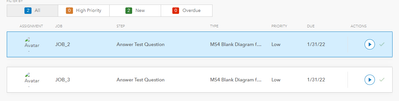

Still can't see the jobs.  I can create a new job in ArcGIS Pro and I can see that job in the web app, but I can't see the jobs in Pro.  I created two jobs using the Workflow Manager Pane in ArcGIS Pro.  They don't show up on my job lists, but they do show up in the Workflow Mananager web app (see below images). Maybe I should note that the test workflow I'm implementing is very simple and doesn't involve any spatial data... it only asks the user if they want to continue and if they answer either Yes or No it ends.... Could that be the problem, their is no location component to the test diagram?

We noticed the Avatar isn't loading also and wondered if I could be related.... the owner of the job is the Job Creator. But even if I change owner to my user still nothing in ArcGIS Pro. But it works in the Web App just fine.. but we want to edit feature in Pro.
