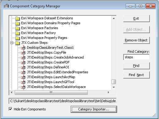

I tried creating a custom step in visual studio using the IJTXCustomStep interface. I successfully registered the dll and I could find it listed in the Component Category Manager (categories.exe) "JTX Custom Steps" node.
But, now in the Workflow manager administrator, while creating a new step with custom step object, I cannot find the ClassID/PrgID while browsing the registered custom steps.
Somehow I lost access to the JTXDesktopSteps node which was visible earlier along with JTXSteps. JTX Desktop steps are now present in the Component Category Manager window. (Please refer screenshot)
Please help me in getting the Registered Custom Steps listed.
