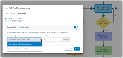

As for restricting edits to the defined LOI, you do have that ability at 11.0. There is an option in the Open Pro Project Items step to apply this behavior when the step is ran.
