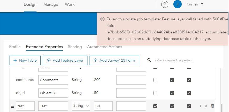

Hi All,
We are using ArcGIS enterprise version: 10.9.1
We have created approximately 18 job templates and in each job template created 4 different "Extended Properties" tables.
We have created a field name "accumulated_depreciation" with type "Double" and this field created in approximately 10 job templates in different tables.
When we try to do some changes in job template (like add/delete field), when we click on "Save" button getting the following error first time.
Subsequent click on the "Save" button, job template updated successfully.
Any suggestions on this. Thanks.

I am also having this issue. I deleted a field after some testing and feedback from the users and now I get that 500:ERROR when I try to add anything to the Extended Properties table or a separate 500:ERROR: Field name collision found: fieldname.
