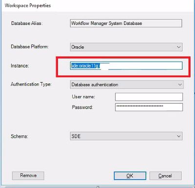

ERROR: The current schema is out of date. Please contact your administrator to upgrade the schema.
When trying to connect to an upgraded database (10.2.1 to 10.6.1)  in Workflow Manager Desktop.
Resolution:
The user properties under the workflow manager database connection must match the connection properties of the geodatabase.
For example: User Properties of the Workflow Manager Database connection:
Connection Properties of the Workflow Manager Database connection:
NOTE: When executing the Upgrade Workflow Database GP Tool, ensure that the aforementioned connections (see images above) match.
