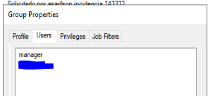

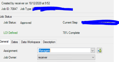

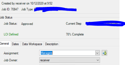

I have a very strange case. I explain, I assign a workflow to a group from WFM, the group is created and has users assigned:
I try to execute it from the REST API but it answers that the step is assigned to another user or group:
"Job is unassigned or assigned to others.
URL: WMServer/jobs/70847/workflow/steps/execute?user=manager&token=TOKEN&f=json&steps=156210&auto=true
If I assign the workflow to a user, the user (who belongs to the group) executes it correctly.

User manager, is assigned to group managers:
