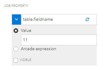

Hi, I have configured a update job properties steps with a default value. However it does require user input. Is it possible to automatically run the steps without user input?
I am aware you can set the step to be automatic but it still require user to input the value.
sirishb
Hi @vtey_esriau
Try the "visible" property with uncheck
sirishb
Hi @vtey_esriau
vtey_esriau
that worked 😄 thank you very much
