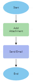

We are using ArcGIS Workflow Manager Server (service-driven). We have create a simple workflow diagram to send email with attachments.
We have chosen "File Path" option under "Linked in "Add Attachment" step.
While sending email WFM is not attaching files from the above given "File Path".
"Send Email" step is able to attach files which are embedded only. (which are manually browse/added using "Add Attachment" step).

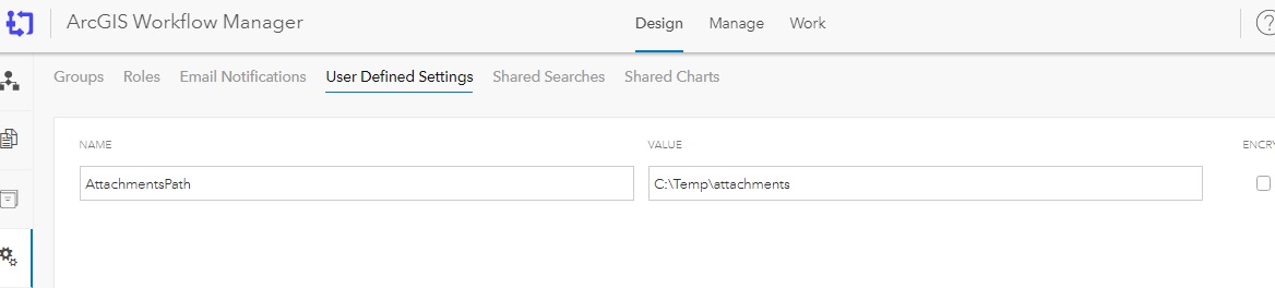

1) we have created a setting under "User defined setting"
OR

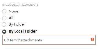

Having an option in "Send Email" step
2) While sending email using "Send Email" step, it should attach files from this path.
