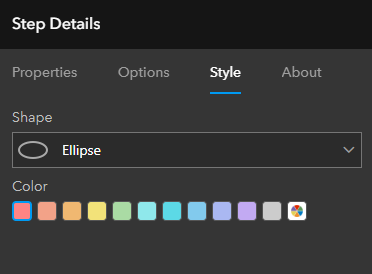

Currently in Workflow Manager, we provide the ability to change the shape and color of any step in a diagram. This allows for some of this grouping you're looking for I think. I've done this below with some of our steps, you can make these changes on the Style tab of the Step Details panel. I've also added some labels above each group by double clicking on the diagram canvas and typing in some text.
Is this what you were looking for or did you have something else in mind?

The current functionality is really useful, we are making use of the colours to depict (at a glance) what team maintains each published geoprocessing service and to differentiate key step types, and we are making use of the shapes to depict what team the workflow is assigned to at any given point.
To enhance our user experience it would be great to select a group of steps and be able to put a box around them, much like you can in ModelBuilder in ArcGIS Pro, and label each group of steps accordingly, for example, 'Data Processing Segment' or 'Quality Assurance Segment'.
