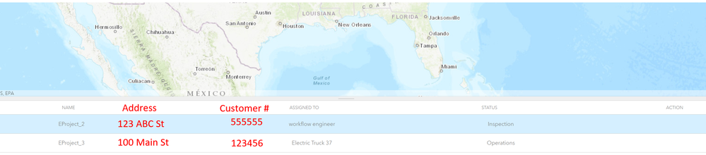

I could not find where this is possible, but it would be very convenient to be able to pull job extended properties (e.g. Address, Customer Number, etc.) into the Display Fields that are shown in the table beneath the map. Many users are more accustomed to scan a table for these attributes than for an auto-incrementing Job Name that they do not use outside of Workflow Manager.

This functionality can be achieved using <extended_property_table_name>.<field_name> in the display field configuration for the Shared Searches. The Display Name can then be whatever you choose.
Note if your extended properties are based of domains, the output will show the domain code rather the description/alias, but otherwise works.
