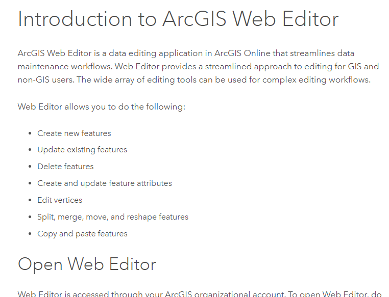

This is all I found in the current documentation about what's supported:
