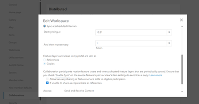

Hi @MelanieBass, we are looking into this. Is your distributed collaboration explicitly set to bi directional sharing? Meaning the Portal can edit the service and share those edits to Online and Online can edit the service and share those edits to Enterprise (screenshot below)
MelanieBass
I dont have it set to copies, I set it to reference and put bidirectional sharing. I have since changed the workspace to copies as well to test and it was the same result.
