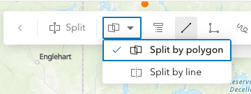

In my current workflow (Environmental Resource Permit mapping), I find that the SPLIT tool will NOT split 2 or more non-adjacent polygons from one another. This means that if I have a polygon consisting of 2 or more merged but non-adjacent polygons (this is generally called a "region"), I cannot "split" one from another, and I cannot select and delete one without deleting them all.
Imagine if each of the 8 major islands of Hawai'i were considered a single polygon consisting of 8 non-adjacent polygons. If you wanted to take Honolulu from that grouping and turn it into a single polygon, the only workflow currently would be to digitize Honolulu over again as a separate feature, and then split or reshape the Honolulu piece of the region until it wasn't visible. Very work intensive, without much return for effort.
Please expedite this request!
CraigGillgrass
@Bill_VS appreciate the feedback.  The Explode tool is on our roadmap but has not been assigned to a release.
I believe you can accomplish what you're trying to do with Web Editor today.  The Split tool can split 2 or more non-adjacent polygons from one another (i.e. multiple parts in a multiple geometry) - try using the Split by Polygon option and encircling the polygon parts you want to split.
Once you split the parts into their own feature, you should be able to work with them as you need to.
If I'm missing something in your use case, let me know.  The Explode tool is on the roadmap but as I mentioned above, not yet assigned to a release.
Bill_VS
@CraigGillgrass that works! Thank you!!!
